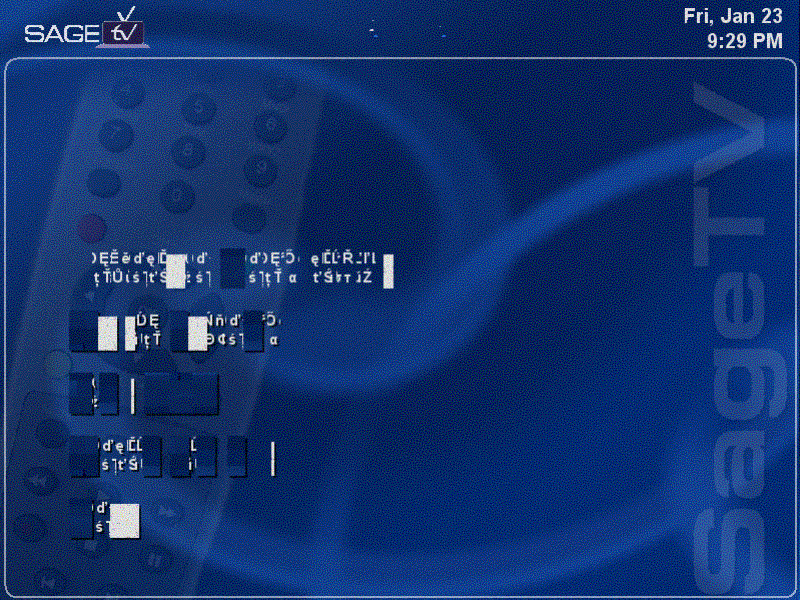

Blank screen + some garbage in V2
Rats! I wish I could get as far as some of the rest of you folks!
Attached is a pic of what I see when I start V2.... Never saw anything like this under 1.4 |

Alas, still no luck. I tried all the recommendations here, but even after a complete uninstall/reinstall, v2 just doesn't work for me. Which is strange, b/c 1.4 never gave me any problems.
I just see a mostly blank screen (with what I do see being garbage chars) as shown in my initial post. ![]() |

When I swapped out my Radeon card for a GeoForce 2 I had in another PC, the display worked. Now that the Radeon isn't in my server, but a client, I'll have to see if SageClient has the same display problems. Meanwhile, I'll submit the issue with Sage not working with the ATI Radeon (72000) to the bug database |
I finally installed the V2 beta last night and got the exact same garbage on most of the menu screens. I also have a Radeon 7200 video card. Is there a fix yet for this issue?
