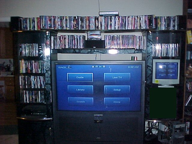

When installing my Sage Box into my current Home Theater system, I had everything tore apart, TV moved out and a plethora of wires everywhere. I hooked up my Sage box to my TV via the TV-OUT from a GeForce4 Ti4200 128 MEG Video Card and had a really good picture on the TV, both with the Sage Menus and LiveTV/Video.
So, being a very happy camper, I proceeded to put everything back in and make it all look nice and clean. Sorta..
Anyways, once I get everything back in place and powered on, I seemed to have lost my great TV picture. Now things on the TV are VERY grainy, pixelated and "loud". As if you take a normal TV and crank the COLOR setting all the way up. The screen
"shimmers" and "pulses", if that makes any kind of sense. The attached pic doesn't really show the effect that is the problem, but it might give some idea.
Is the Ti4200 *too* much a card for this setup? Although I never thought such a concept was possible. Like being TOO rich, you can never have TOO much power. At least, I thought not, anyways. In any case, if that is the problem, I can plug in a TNT2 Ultra 32MEG AGP card.
Can anyone point me to a FAQ or info that might shed some light on this problem?
Thanx

If it was all working before, but not now I would say maybe it is a connection issue... Double and triple check that your connections are good and that the way you ran your wires you aren't picking up a bunch of interference (I've had this before running even GOOD video cables along side power cables).

Thanx Jason. I'll give that a shot, although I dread diving back into that mass of cables, cords and connections..
Another thing that might indicate the problem. At boot up when the WINDOWS 2000 Splash screen is shown with the indicator bar is across the screen.... On my monitor that is in full normal color, but on the TV it is black and white. After it finishes and goes into the desktop screen, color returns to the TV. I don't know if it means anything or not.

Seems I have a fix for my issue, but I have no idea why it works. :^)
Loading up TVTool 9, there is an option for COMPOSITE connection or SVIDEO (Y/C) connection. Seems my setup was set for COMPOSITE, although I have no idea why or how.
In any case, I set it for Y/C and 'viola! Perfectly clear screen.
