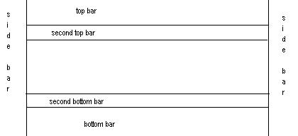

Sage 16:9 or 4:3 or Source
When I watch regular SD TV through my projector, and watch specific shows that are presented in widescreen(example Smallville), I see black side bars, black top/bottom bars, then within that area, another top/bottom bars that are slightly less black(see attached). When a comercial shows, the second set of top/bottom bars goes away. Do you have this same problem? I've tried all the different combinations of settings above, but still have black bars of some sort, except maybe for the commercials.
I forgot to add, this is through an HDMI cable

Well, I finally got everything figured out. I had several problems, but I'll list how I overcame each.
1. The A, B, C, D buttons on my Firefly remote wouldn't activate the saved nVidia hotkey. I added the button action to both the Sage and Global profiles. I probably only need to add it to one or the other, but adding it to both seemed to give me higher chance of the function actually happening. I don't know if this is Firefly or nVidia, but now it works about 90% of the time. The second thing I also did was add the functions before the line starting with Identifier ClassName="sage.SpecialWindow". Again, I don't know if this absolutely necessary, but ABCD buttons would only work in Sage if I didn't.
2. SageTV goes black screen when switching displays. Close SageTV before switching displays.
3. nVidia hotkeys are being deleted when swapping displays. Hotkeys are not global as Lucas pointed out. I made sure to save the profile after each hotkey addition.
4. New nVidia drivers version 93.71 frack everything up. I deleted the new drivers. For a bit there, I thought I was going to have to reinstall Windows. I tried installing the drivers 3 times and each time, I would get no video output after swapping displays. Thank goodness for Windows Safe Mode and System Restore.
5. Black bars on top, bottom, and sides. Depending on the TV show, I needed to have SageTV's Aspect zoomed to Source=100%x100%, 4x3=135%x135%, and 16x9=103%x103%. Depeding on the TV show, using one of these 3 settings gives either no black bars or just one set of black bars. Does anybody know how to add this as a hotkey? Currently you have to hit option, then aspect, and finally scroll through each Aspect. I also had to set my TV at 720x480 resolution and the Projector at 1280x720, thanks ben_95sl1.
So when all is said and done, Firefly buttons load the profile for: A=computer, B=Projector, and C=TV, and everything works. I can only hope nVidia eventually release a new hotkey for switching to the next profile, then I'll save 2 buttons on the Firefly remote.

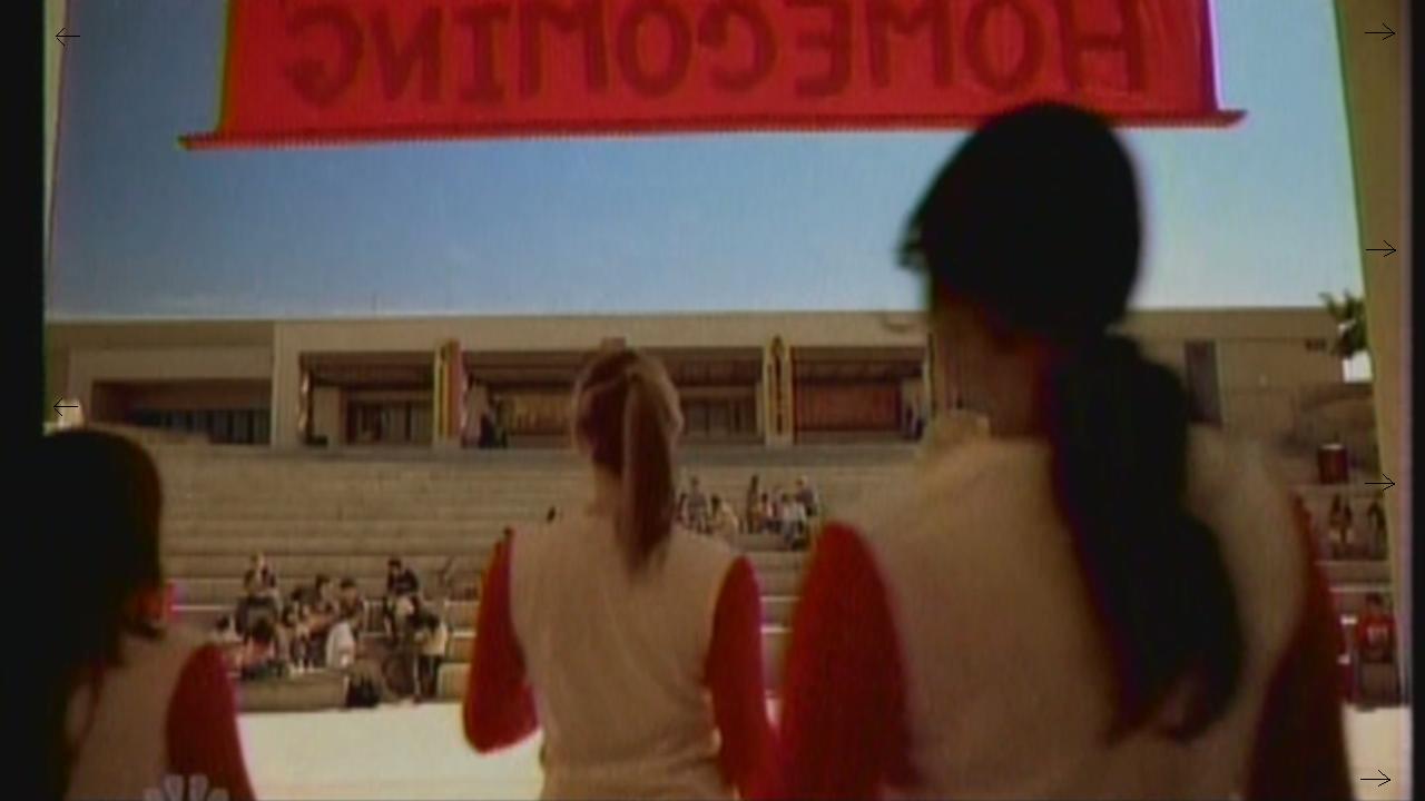

I figured out how to use one Firefly button to swap profiles. You can just jump to the next profile, Desktop->PJ->TV->Desktop, using 1 button. The only problem is nVidia is deleting the hotkey only when the TV is launched. I'm saving the profile correctly, so I don't know what's going on. I'll play with it some more.
Another strage thing, don't have the nView Desktop Manager open when using the hotkeys. It was mixing up my profiles. When the TV was on, nView Desktop Manager was still on the PJ profile. Manually selecting a profile fixed this.
ben_95sl1,
Yes, I should have caught that, 640/480=1.333. Playing with Sage's zoom, it's amazing how much of the picture is cut off in regular TV. Red Planet was just on in 16x9. I would say 5-10% of the left/right part of the picture is cut off.
Do you think the ATI or the nVidia has a better picture? I still have translucent bars on the far right and left. Gigabyte says I need to adjust the overscan, which is BS. The bars are on my TV, PJ, and LCD monitor. See attached. I'm still under warranty, so I may return it.
