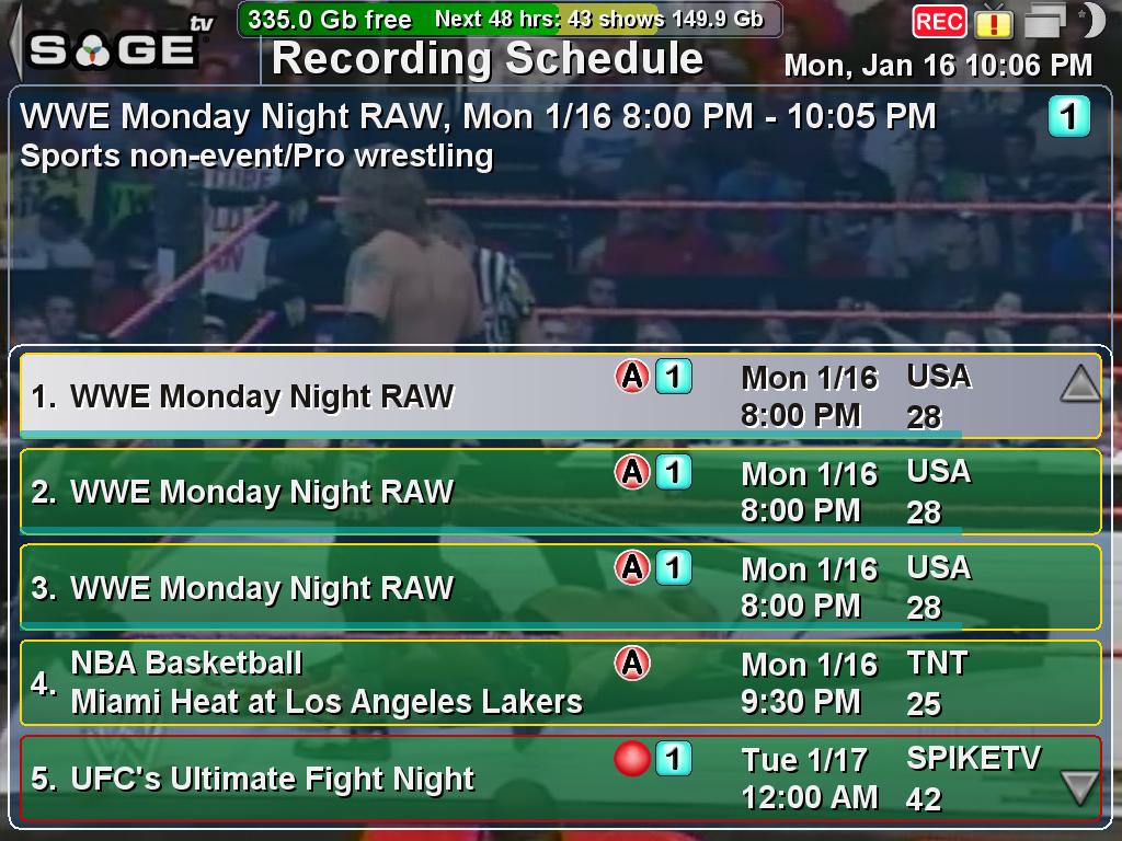

I was just watching tv when the video started to stutter very badly as if my cpu was in full use. I check task manager and find sage using 100% all of a sudden. Seems odd since it's only recording two shows and I'm watching one of those.

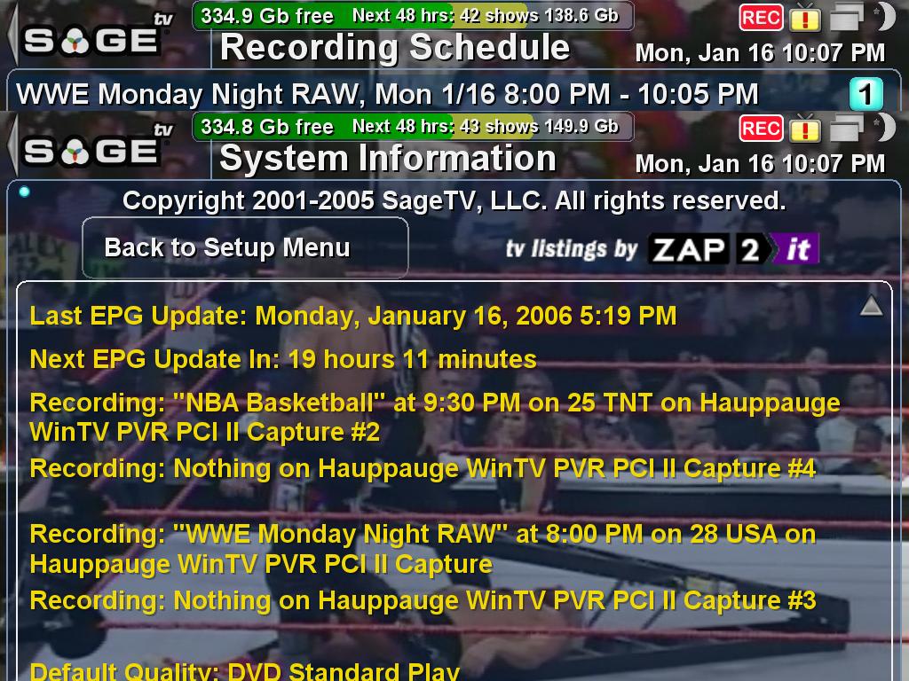

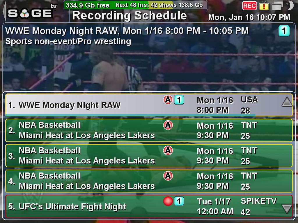

Then I notice the conflict icon up top that wasn't there just a little while ago so I check conflicts. It's continually pulsing between the two shows I'm watching and treating them as conflicts. I mean non-stop. Two conflicts one conflict two conflicts one conflict two conflicts one conflict and so on. So I check system info and find that the two shows are recording and my other two tuners are not recording anything. Shouldn't be a conflict. I check recording schedule and I see what is in the attached pics. My two recordings have taken up 4 now recording slots in the schedule. The orientation of them is constantly changing. Each show always appears at least once, but then one show will duplicate and triplicate and then the other show will take over and do the same. Any ideas what is going on? I've never seen or heard of this one before. All screen shots were taken within seconds of each other. |
I'm having something similar happen, but only with a manual recording schedule. It shows up as a conflict with itself, though it is only listed in the schedule once. I've seen it show up to three instances of the same recording under the conflicts. I’ve even seen the start time change from 6am to 7am and then back a few minutes later. I was making NO changes of any kind at the time. I have deleted and rescheduled this reoccurring recording several times and it has happened each time. I'm using the latest non-beta build - I will try the latest beta something this week and report.
That happened to me once
That happened to me once after I updated my video decoder drivers and reboot. I removed all my input sources and redid them with the latest EPG data, exited out of SageTV, reboot my computer and things started working right again.
