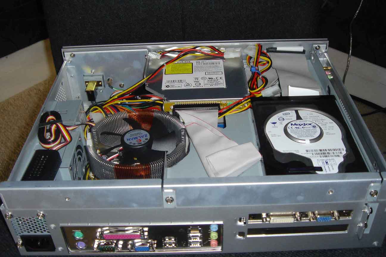

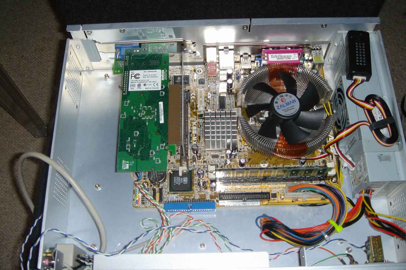

I have just built a (bedroom) client machine based on the Silverstone LC-02 Case (see link).
http://www.silverstonetek.com/products-lc02.htm
This case is incredibly small! The temps inside are also pretty high. It runs at about 55-58 degrees C (mobo temp and CPU temp). The side of the case where the PSU is located almost gets too hot to touch. But thats all another issue.
I need a graphics card that is passively cooled yet doesn't kick out much heat. It doesn't need to be cutting edge, I'm even willing to use overlay with it if necessary. It just needs to run REALLY cool. I don't want to add any more heat (or noise) to this machine. Maybe something like this:
http://www.yoyotech.co.uk/scripts/pr...idproduct=1456
I have attached some pics of the build for those that want to look.

Looks like there's spots on the side vents where you could add one or two fans.
From the looks of that CPU fan and it's location inside the case there doesn't look like much room for it to actually move any air. The top of the cpu fan looks like it's just about touching where the top cover would be.
Other than passive cooling throught the side vents it looks like the only heat getting out of the case is through the tiny vent on the power supply. If the FlexATX PS on my MediaREADY 5000 is any indicator then VERY little airflow is coming out of that area. BTW, how is the PS fan for noise? It's horrible on the MR 5k's PS.
Not sure how quiet you could keep it, but putting a fan in each side, one blowing in and the other blowing out would definitely move some air through the case and get rid of some heat.
I just don't see any way for heat to get out of that case without some fans on the side vents.

I have actually put two 60mm fans in the case. One sucking in air on the left and one blowing air out on the right (looking at it from the front).
The PS fan isn't THAT noisy, but the PS gets HOT. REALLY HOT.
There are vents in the case top right above the CPU. Air is being sucked in by the Zalman CPU fan through this vent.
Future thoughts are to replace the HDD with a laptop drive (This will cut down on both noise and heat) and also to swap out the stock PS fan for a 'quiet' model (no heat change there).
