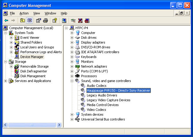

Is there Any Way to Rename the PVR Cards?
I'm running sage with a 150 and a 500 in my computer.
I always get confused which 'controller' is which in the computer...is there any way to rename say the PVR-150 to 'Digital Cable' instead of 'Hauppauge PVR #3'?

They do/should, but you should be able to modify the "friendly name" which is the name that windows displays for it.
FYI - Since I didn't feel like messing with my server, I just changed the name that windows displays for my xcard. Used to display as "Sigma Designs Xcard MPEG2 Decoder" - I changed it so now if i go into the device mgr it just says "Sigma Designs Xcard" - It still works perfectly fine. I had to change the "devicedesc" key located in HKEY_LOCAL_MACHINE\SYSTEM\CurrentControlSet\Enum\PCI...
I would imagine that this would also work for a PVR card, I just don't feel like trying it because I have no need to. Changing it may also require going through the setup wizard again since it'll now see the card by a different name.

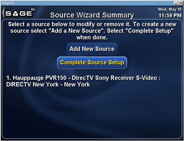

Ok, I didn't have anything else to do so I started messing with the PVR card. If you look at the attached screenshot you'll see that I named the tuner "Hauppauge PVR150 - Directv Sony Receiver"
I had to edit the "friendly name" key in "HKEY_LOCAL_MACHINE\SYSTEM\CurrentControlSet\Control\DeviceClasses\
{65E8773D-8F56-11D0-A3B9-00A0C9223196}\##?#PCI#VEN_4444&DEV_0
016&SUBSYS_88010070&REV_01#4&10416D21&0&00F0#{65e8773d-8f56-1
1d0-a3b9-00a0c9223196}\#{9B365890-165F-11D0-A195-0020AFD156E4}\
Device Parameters"
*(your location wont be exactly the same, but they should be in the same general location except for the stuff after DeviceClasses)
There should be a friendly name for each tuner you have #2, #3, #4 etc...
This is probably not for you if you aren't familiar with registry editing, but I changed it and it's working perfectly fine - also it should be noted that i DID have to run through the setup wizard again.
