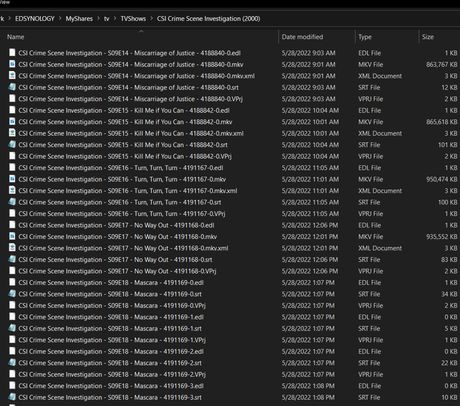

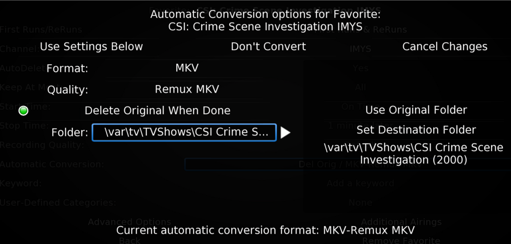

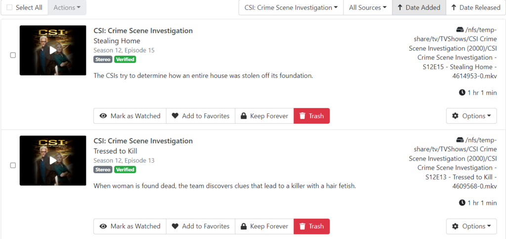

I convert to MKV and have them put in the correct folder structure that Channels DVR uses. I setup favorites hat I want to keep in Sagetv to auto convert .... Also converting to MKV Remux also helped seeking of TVE recordings made by SageTV ... When you convert you can have SageTV convert to any folder even not in SageTV and the recordings will still be available to SageTV.
For Example
Channels DVR UBUNTU Server 2 Primes 3 Connects TVE SageTV Docker with input from Channels DVR XMLTV and M3U VIA Opendct.
