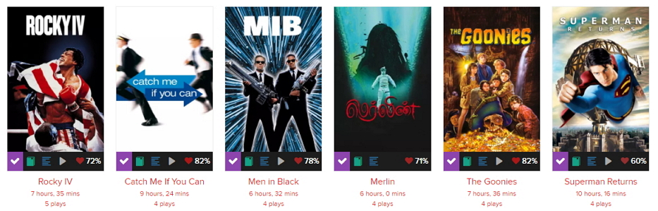

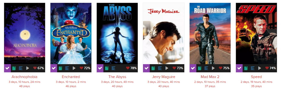

Using 0.5, the decrease is incredible. That L&O episode decreased by 2 watches, BTW.
Before: Most watched movies: After: Most watched movies: BUT... there's a nasty little side effect to the new RealWatchedEndTime setting. Anything marked as watched in the guide, but never actually watched, will not be sent to Trakt at all when this setting is enabled. For example, Arachnophobia doesn't show up as ever being watched. Likely, that's technically true, as I probably just marked it as watched so that the intelligent recording engine wouldn't record it for me. However, even as obsessive as I can sometimes be, I doubt I would've marked a single movie as watched 48 times. IMO, something still seems off with how Sage is determining whether something has been watched. I continue to wonder if Sage goes through every guide download and tries to match up previously watched airings and marks them as watched again. Perhaps, Arachnophobia simply showed up in the guide on 48 separate occasions and Sage marked 47 of them as watched on its own. Or, it could be what Tiki was mentioning. Without knowing how Sage works, I can't offer up any suggestions for 'fixing' this. What I can say for me, though, is that I'd be happy if the only thing sent to Trakt was the first instance of something getting watched. That goes for both the initial, bulk upload to Trakt, as well as future updates to Trakt.
Server: XP, SuperMicro X9SAE-V, i7 3770T, Thermalright Archon SB-E, 32GB Corsair DDR3, 2 x IBM M1015, Corsair HX1000W PSU, CoolerMaster CM Storm Stryker case Storage: 2 x Addonics 5-in-3 3.5" bays, 1 x Addonics 4-in-1 2.5" bay, 24TB Client: Windows 7 64-bit, Foxconn G9657MA-8EKRS2H, Core2Duo E6600, Zalman CNPS7500, 2GB Corsair, 320GB, HIS ATI 4650, Antec Fusion Tuners: 2 x HD-PVR (HTTP tuning), 2 x HDHR, USB-UIRT Software: SageTV 7 Last edited by Skirge01; 10-16-2018 at 12:37 PM. |
