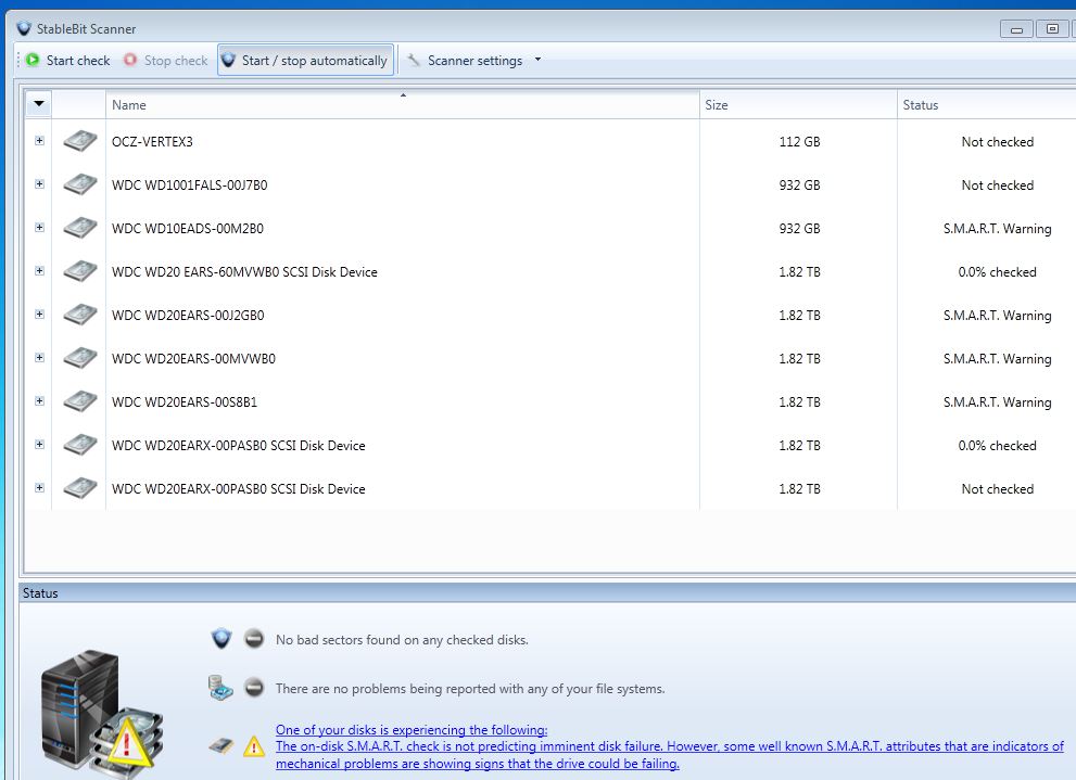

Hooray SMART errors
Well, I decided to get some drive monitoring software since I decided to go with WD Green drives and they're all getting around 3 years old. Well, 4 of them have SMART errors. I'm going to replace them now to avoid issues, but I wonder what type of drive to buy. I'm leaning toward the WD Red drives, but would like some suggestions from you guys.

The LCC count is high? In the hundreds of thousands?
Yep. 493143, 429654, 508194, 340020 on the 4 drives showing the errors. All WD green drives. 3 drives aren't able to get any SMART data due to them being eSATA or on an expansion card. It's literally happening on EVERY green drive that is readable.
EDIT: Update. HD sentinel is showing almost perfect health for all drives, even with the LCC count being very high. Interesting.
That is what I figured. Lots of people turn off or limit the head parking when they see them start to rise. But unless you see >100,000 in weeks to couple of months time frame it really isn't something to be concerned about. If your drives are a year or older and while the LCC counts are high they are still usable. I would however turn off the head parking with WDIDLE3 (YouTube) if you intend to use them 24x7 anywhere.
Windows programs have a real problem getting smart data through controller cards. I had the same problem with AOC-SAT2-MV8 and AOC-SASLP-MV8 cards. unRAID (Linux) had no problems with same cards. I would turn off the head parking as I mentioned if you want to continue to use them. The high LCC's are not considered really bad until you hit the millions. If I remember correctly it was 2,000,000 someone posted was a limit. But I'm going from memory and there was a dispute if it was a real drive limit and it would stop functioning or just a smart reporting limit. The ones highlight on the wiki entry in red are the ones to look at the most. The others need to be looked at in context. For instance the "UltraDMA CRC Error Count" could just indicate bad cabling and is nothing to worry about if they are not recent.
I'll go ahead and do that. Thanks for the info.

Originally Posted by Skirge01 View Post
With HD Sentinel doing the monitoring duties, I generally run Anvil's Storage Utilities (free) on a new drive 24/7 for a couple of weeks.
Awesome. I'll have to make that a practice now that I have these issues. From what I've read here and elsewhere its not a problem yet, but these drives are getting old and need to be replaced anyway so I guess I'll be building my new fileserver.
